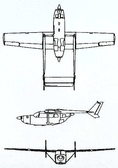

Dr. Marisco, a dermatologic surgeon, and Ms. Moran, the pilot, were flying back to Ohio in Dr. Marsico's Cessna 337 when it developed an engine problems and went down about 10 miles from DeKalb-Peachtree Airport in Georgia on Aug. 8, 2007. A post-crash fire ensued. Dr. Marisco and Ms. Moran both suffered multiple injuries, including third degree burns covering nearly 40 percent of their bodies.
The NTSB notes in its probable cause report that "the pilot, age 34, held a commercial pilot certificate with airplane single engine land, multi engine land, and instrument airplane ratings, and a CL-65 rating with "SIC privileges only." The pilot reported 4,650 hours of total flight time, with 145 hours in make and model. Her latest FAA first class medical certificate was issued on June 5, 2007."
At trial, attorneys for the plaintiffs said Dr. Marsico's Skymaster had been maintained by Winner Aviation prior to his acquisition of the aircraft, and he continued that relationship after he purchased it in 2006. According to the attorneys, from 2006 until the time of the crash, the Skymaster had reportedly experienced recurrent problems with its rear engine. Winner Aviation performed repeated troubleshooting on a waste gate. On the day of the crash, the rear engine on the twin-engine airplane lost power after takeoff, and attempts to restart it failed. Ms. Moran was unable to maintain altitude and attempted an emergency landing. A post-crash fire ensued.
At trial, plaintiffs claimed, among other things, that Winner Aviation did not maintain the aircraft in an "airworthy condition." Plaintiffs further alleged that Winner Aviation's misdiagnosis of the recurrent problems of "power loss" in the rear engine was compounded by an alleged failure to have an appropriate inspector investigate all work that was being performed by its mechanics. Plaintiffs also alleged that Winner Aviation was aware that the front engine was long overdue for a complete overhaul, but did not recommend an overhaul to Dr. Marsico. Plaintiffs argued at trial that the failure to overhaul this engine or, at the very least, perform a proper inspection and repair of its valve guides and other engine parts, caused a diminution of power during an in-flight emergency—precisely when full power was most important.
