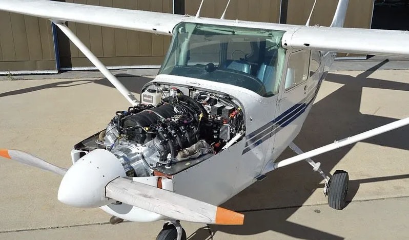

Another update on the Corsair V8 project
The regulatory barriers just not moving at all. I have to admire their persistence but fear it is really tilting at windmills.

Certainly a number of interesting points there. For now let’s discuss this V8 project by way of example and since it was the OP.
To start with let’s just review the basic facts. As I understand it these guys have worked out a way to use a V8 aluminum marine engine on a C172. They state it provided operation at $20/hour on unleaded auto fuel.
Is this basically correct?
Now my question - can they presently legally set up shop to sell this conversion , performed by them, to any owner of a C172, including flight schools and FBOs, who can then legally use or rent this aircraft to others?

Yes.
Yes.
performed by them
Yes.
Yes.
who can then legally use [it]
Yes.
I think so. But I believe it will take an additional FAA LODA to rent them….
Yes.
So just to be clear - these guys could advertise saying it is a excellent and efficient engine conversion, perform this on customers planes without any additional approvals from the FAA and it would be legal and comply with regulations?
However their customers could not rent out or use such an aircraft commercially without a LODA?
What would obtaining such a LODA entail? Would every operator need one for each aircraft so modified?
Could a private owner fly it themselves with no additional approvals?
They already have advertised that on their website and other literature. They offer/offered a firewall forward kit for the 172 and similar aircraft (Alpha 1) and a kit for E/AB aircraft (Alpha X2).
However, I doubt they would perform the work themselves as they seem to have a bit of an aversion for liability issues.
But keep in mind we are talking about Special AWCs and experimental category aircraft with the V8. So a number of regulations are not applicable. The only FAA involvement with the V8 kit would be for the owner to apply for the Special AWC under Experimental Exhibition and receive their certificate and operating limitations. Which is exactly what Corsair did and how they flew it.
I believe so for rental, but do not follow this specific topic much. However, it is the same process used for E/AB or other Special AWC aircraft when rental, training, and other type ops are performed. For example, Corsair provided the V8 to a student to get their PPC to include the FAA check ride, but don’t know how they provided that aircraft to them. That event is also contained in their literature.
But no on standard commercial ops. Now how the LODA fits into that I don’t know so it might provide some limited “commercial” ops like a tow aircraft or something. Perhaps review Part 91 for more details?
I think you just send a request to your local FSDO.
No.
Yes, except for obtaining a Special AWC and ops limits as mentioned above.
