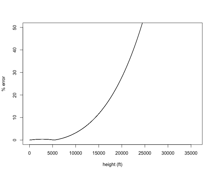

Just for fun here are two plots. The first is the pressure as a function of altitude for both the more accurate formula and the linear approximation. The second is the percent error in the linear approximation as a function of altitude. Reaches 5% at about 12,000 feet.

These are just graphs of the predicted pressure, using both the 3% rule and the more accurate rule, as a function of height above MSL in the standard atmosphere. So if the temperature is standard, then I think the performance should be proportional to the pressure if the engine is leaned properly. If you go to the height corresponding a given density altitude, I think that should give engine performance for that DA fairly well.
