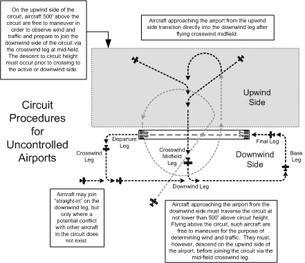

Do I understand correctly that you flew the crosswind midfield leg as in this diagram?
(This is the standard in Canada at uncontrolled fields. Note that crossing at midfield is done at pattern altitude. Hence my joke about telling the controller you're Canadian.)

The tower guy explained he didn't like my pattern entry, saying that crossing over midfield at pattern altitude like that was technically a pilot deviation and present a safety hazard for departing traffic.
You could have collided with departing ballons, helicopters, and rockets launched from midfield, so technically he is correct. On the other hand, except for some STOL airplanes and fancy expensive VTOL jets, it is probably the one place over an airport where you wont run into any airplanes taking off. All the high-power airplanes that seem to have outrageous climb rates also have outrageous forward speed, so by the time they get to pattern altitude they are farther down the runway than most people instinctively would guess.
So there is a reason the Canadian circuit rules are what they are. They aren't all a bunch of hosers up there, eh?
