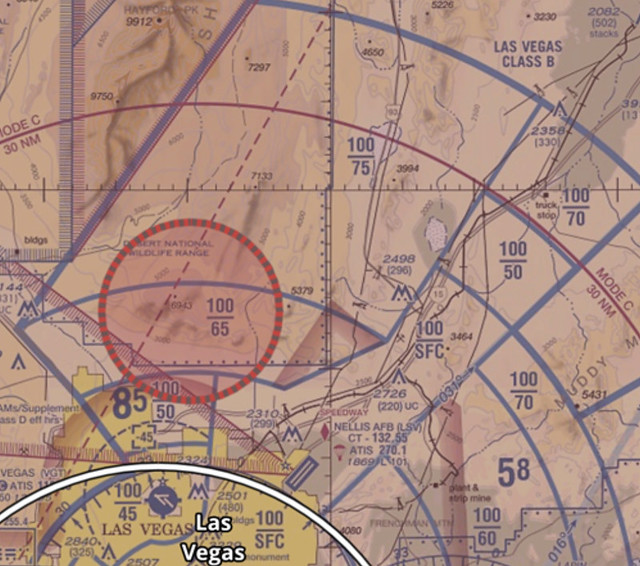

Last night a Cirrus apparently flew straight into a mountain just north of Las Vegas.
Lots of comments on COPA so far. The pilot was experienced, familiar with the area and a former ATC controller, which makes the accident hard to explain.
One thing which struck someone - and me - as odd was that they would establish a floor to Class Bravo with a mountain sticking up into it:
(The red circle is a TFR for the accident site)
Maybe this is common, but it seems potentially dangerous to find a mountain right where you’d be maneuvering beneath a Class Bravo shelf.
Tragic, regardless.

That is a horribly drawn airspace. Ultimately, the poor guy was PIC, but the airspace designers are accessories in this - as is anyone who created a culture where he thought he couldn't get a clearance in that area.
I believe that shelf was put so low there in order to allow parallel runways on the 2 south runways at KPHX, which they did not end up often doing.
Not really. The tower told him to extend his upwind. He then turned into the path of a mountain that he wouldn't be able to climb above because of the Bravo shelf. Now, there were other mistakes made - particularly involving situational awareness - but the preflight was probably ok.

I was flying out of KFFZ just a few weeks ago VFR during the day with an instructor. He normally works out of KCHD. He was really impressed by how close this shelf is and commented also on the bad design.
Palmpilot said:
By the way, when did that shelf change? I have a 2012 sectional that shows it being at the same location and altitude as it is now.
I think 2007. I was not a pilot then but remembered the complaints about noise changes shortly after we moved here in 2005. The accident was in late 2011.
