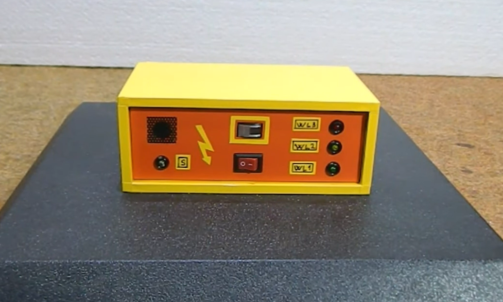

Interesting idea Jim. What sort of underlying platform would you think to use? Would it qualify under non-certified safety enhancing equipment?
A much simpler version than that required for aviation purposes, but might contain some idea.
