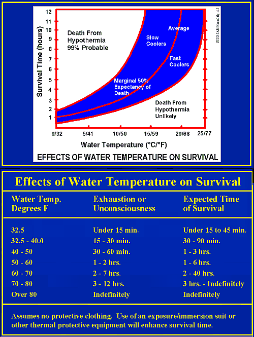

With regard to survival times, below is an image showing likely survival times (hot-linked from a link in the article "Ditching Myths Torpedoed"
http://www.equipped.com/ditchingmyths.htm worth a read if you haven't already seen it.)
proxy-143-gif.350
