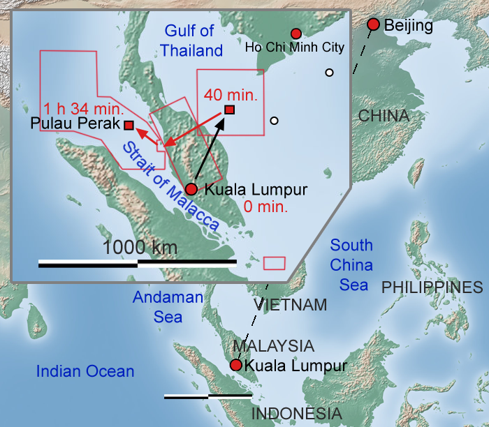

Do you know how often ACARS makes transmissions? From my limited research, I get the impression that while the last ACARS (presumably over VHF) transmission occurred before the last audio and transponder responses, the time between ACARS transmissions would have been large enough that one can't really say when ACARS VHF stopped working. So ACARS VHF, audio comms VHF (I assume they were not on HF), and transponder transmitters could have failed simultaneously and still be consistent with reported information.
For what it is worth, according to the map assembled by some Wikipedian based on published radar information, the direction of the first turn appears to have placed them on a course for the nearest large airport, at Khota Bharu, which would be consistent with your theory (since one would divert to the nearest airport one could land at):
proxy-112-png.357
https://www.google.com/maps/search/.../@6.0482626,104.3238342,855509m/data=!3m1!1e3
