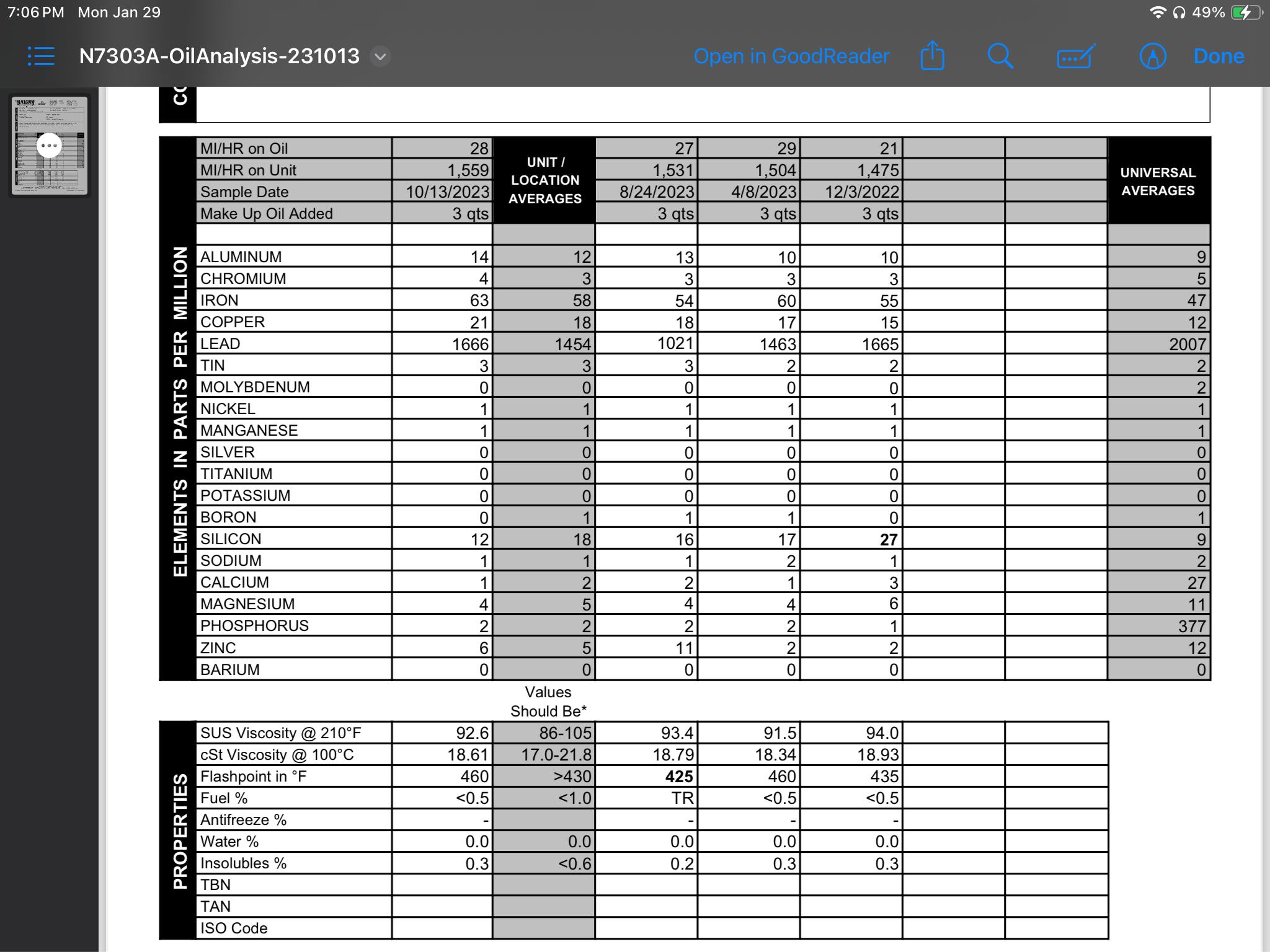

The engine has under 1600 hours since last overhaul. Oil analysis trend looks good to my untrained eyes (attached if interested.) The plane will probably be flown between 100 to 200 hours per year (5 person flying club.) With only a screen the oil changes would be about every 25 hours. My thinking is that if a filter adapter is installed oil change still every 25 hours but filter every 50.

Since you plan to fly over 75 hrs you are more on the benefit side of having a filter installed to include upping the oil changes to 50 hrs. However, oil change intervals are also calendar based which I believe is more important in the big picture of engine health and longevity and should be included.
So some of the principal pros of a filter install are savings on oil costs due to the increased hourly change interval, increased filtration vs hours flown, and improved oil condition monitoring via filter inspection. The principal cons are possible installation issues, a higher initial cost for installation/ROI and higher oil change costs due to filter costs. However the filter costs usually are a wash given you won’t be changing the oil as often vs a 25hr interval.
The filter cons come more into play when you fly less than 75hrs per year as any oil condition/monitoring improvements are not as evident when compared to the 25 hr change interval with a screen.
Regardless, there are many opinions on this topic, and as I noted, its my opinion this review method is only valid if you include the 4 month oil change limit as well. For example this can be easily done by breaking your flying year into three, four-month intervals. So whether you fly 1 hour or 49 hours in that 4 month interval the oil and filter will be changed. In my experience, this gives the best oil condition and the best bang-for-buck in the long run.
If you want more details or have questions be happy to post/answer.
