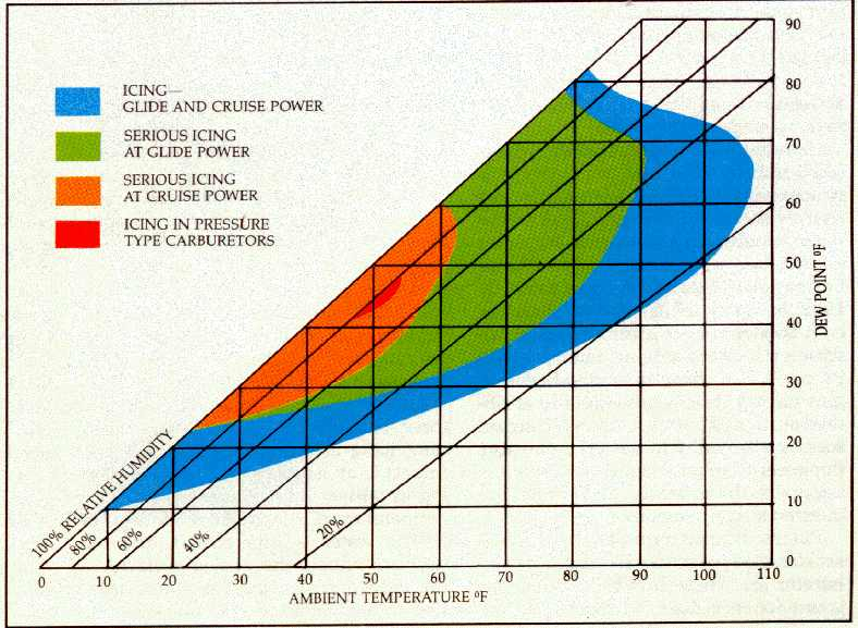

Never considered or had a problem with carb I've on the ground, it was 65 degrees and somewhat humid when the engine died on the ground. If it was indeed carb icing, I suppose the rich mixture didn't help and contributed to the abrupt stop of the engine.
On my cross country, it was between 30 and 40 degrees and I was at 4500 feet, not sure about the humidity, but I couldn't tell there was much because my visibilty was practically unlimited.
This diagram showing carb ice probability may help:
