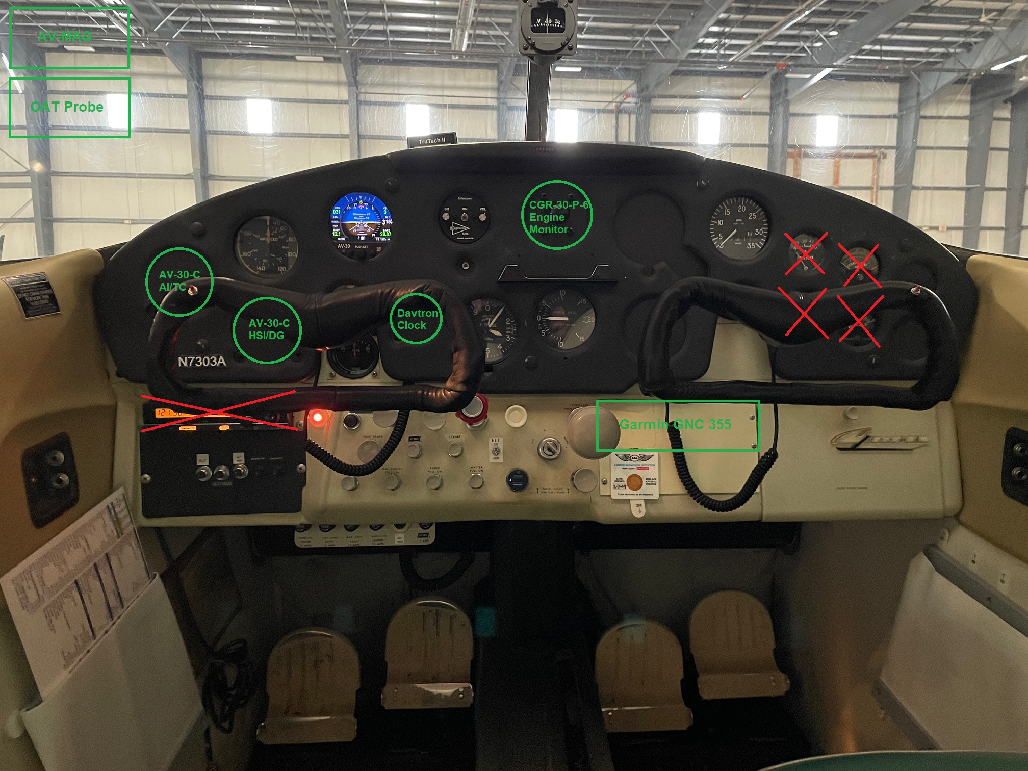

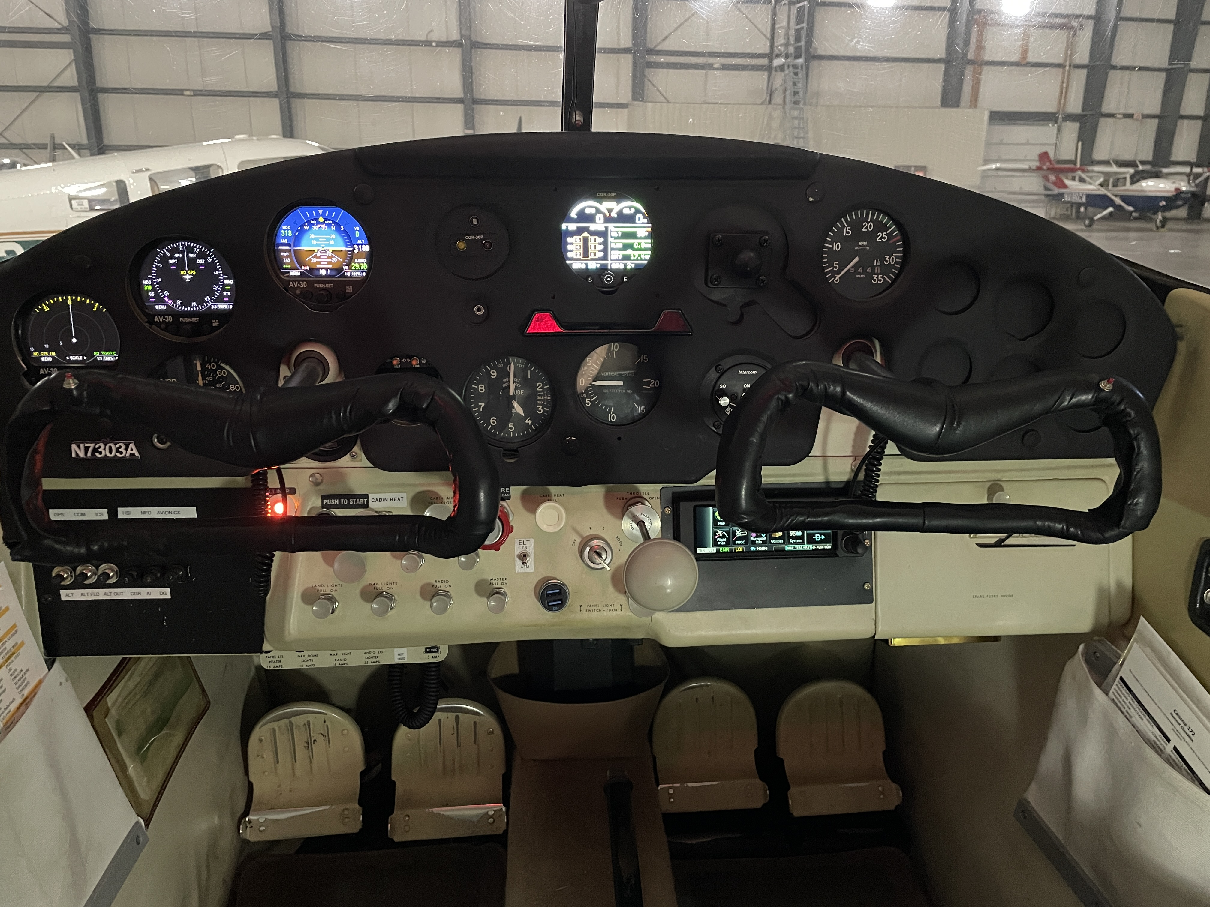

I'm planning to upgrade my 1956 C-172 to be IFR legal enough to learn and exam for an IFR rating. For navigation requirements my research indicates I could do it with a single WAAS GPS solution like a Garmin GPS 175 or GNC 355 tied to a HSI display. A local CFII suggested I should also install a unit capable of VOR, ILS, and marker beacon receivers and indicators. That roughly doubles the equipment cost (unless I go with a used Garmin GNA-430W) but I'm not sure it actually brings extra value equal to the extra cost. For example, VOR and ILS don't seem to provide any actual redundancy against GPS failures since many desired destination airports have only GPS approaches.
