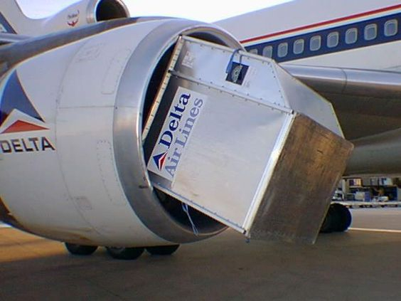

I read somewhere why they can’t put such protective mesh around jet intakes but I don’t know what effort has been made wrt to props. I can’t picture flying with a big mesh around it like my fan here.
The inlet "mesh" would impede and disturb the airflow into the engine and reduce efficiency and performance. Also you would have to heat the mesh to prevent ice formation. Its used on smaller turboshaft engines within the cowling but on pure jet it tends to create more problems than it prevents.
