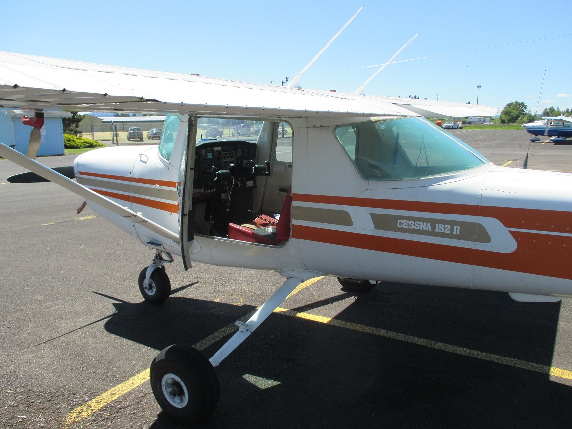

I actually intended to do the same with a C-172 but after I finished the experiments in the 152 I lost interest. Never got around to publishing my results until now.

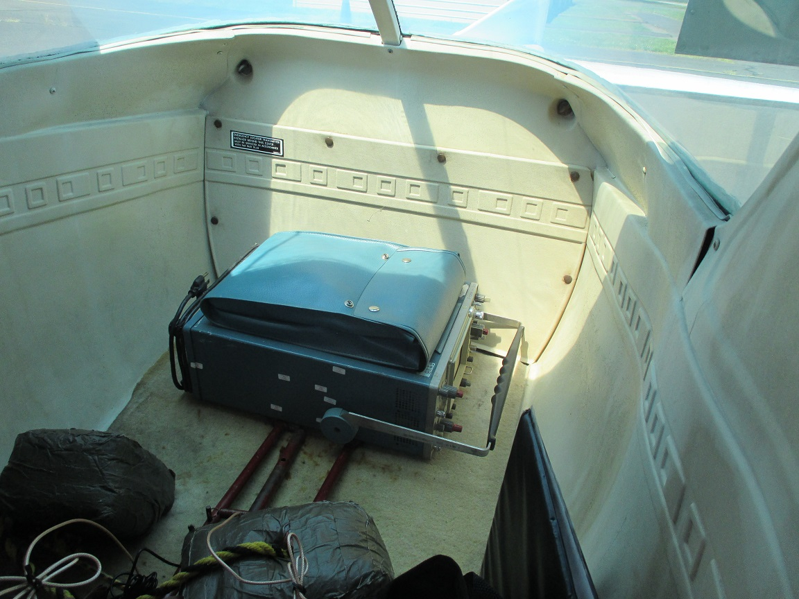

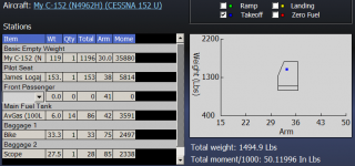

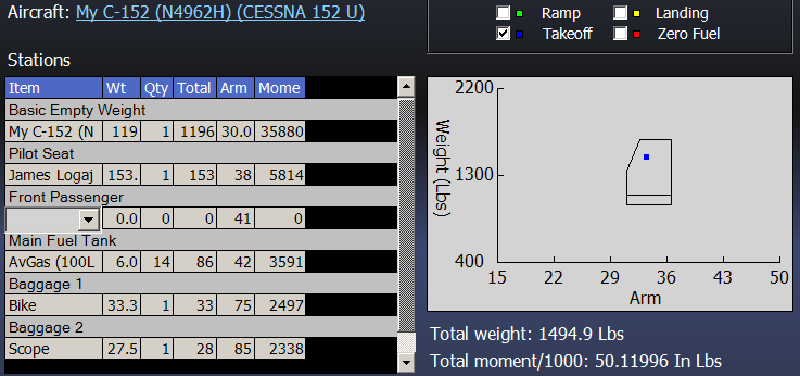

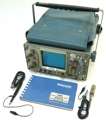

One note on the airplane's configuration I forgot to mention is that I wanted to push the CG aft so it was closer to the center of lift. My theory is that should slow down the speed at which the nose would drop. Since it was a "scientific" study I picked a piece of scientific gear as dead weight and shoved it to the back. It was a Tektronix 465 Oscilloscope weighing about 25 pounds.

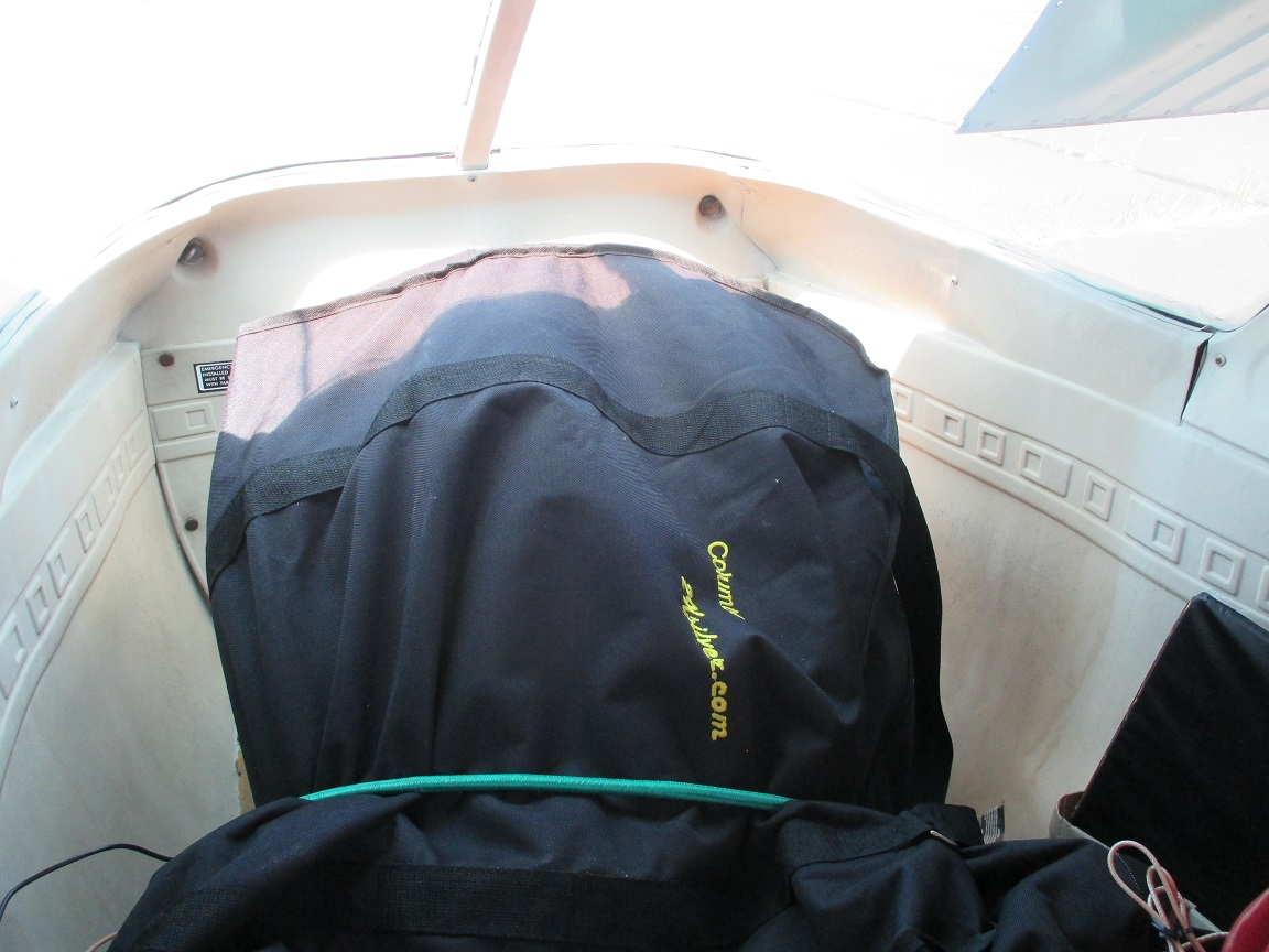

I thought I had lost these files, but found them in a directory with the wrong date. I had forgotten that I had also placed a folding bike in the back of the C-152. Even with those weights in the back you can see the CG is still in the middle of the allowable range. With just a student and CFI the CG is fairly far forward in those planes.
(I was curious whether the folding bike would fit in the back of the C-152, hence my choice.)

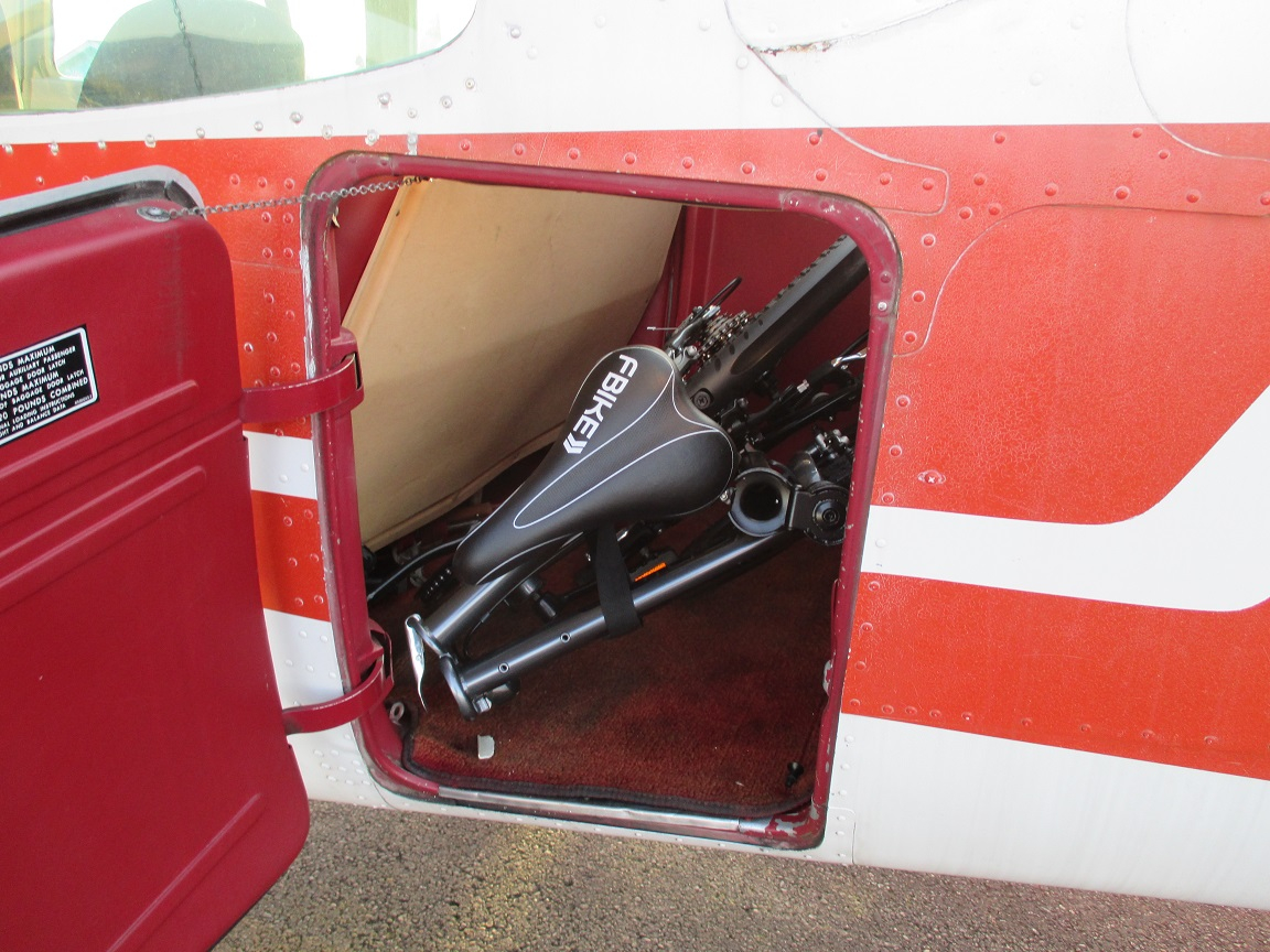

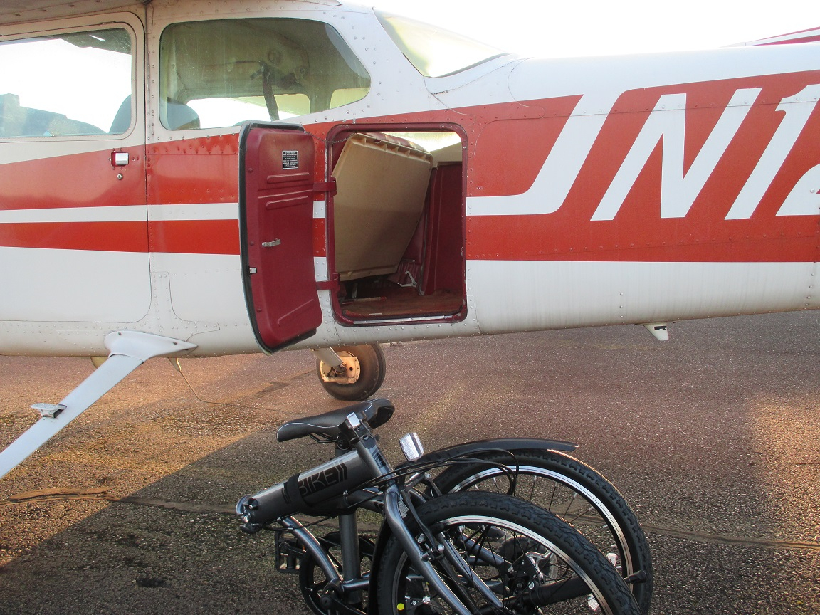

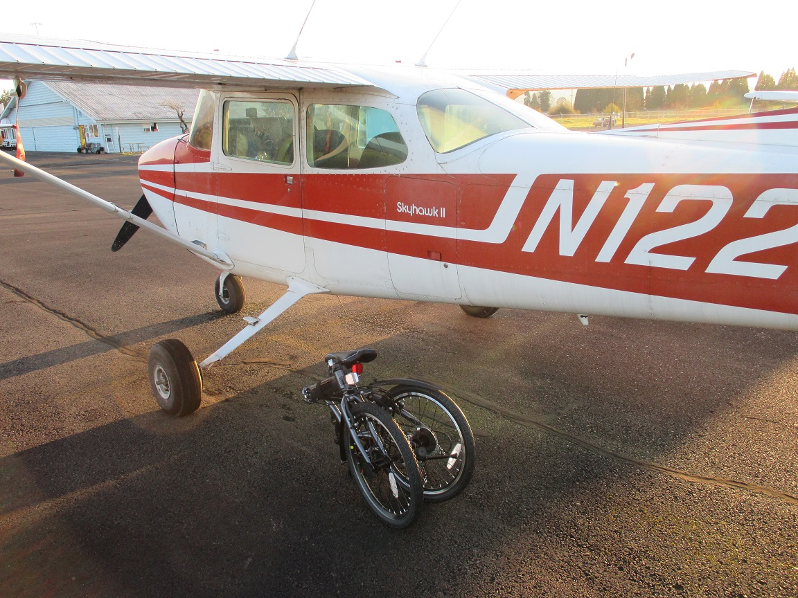

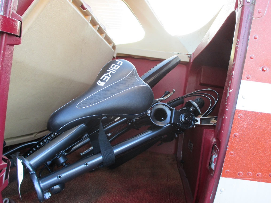

Side note: the folding bike cost $250 when I bought it in November 2013. The company was fBike and sold a variant of a Chinese made bike. The company itself eventually folded. Attached are some photos of the bike when I tested to see if it would fit in the baggage area of a C-172. This is before I bought the carrying bag that I used in the C-152 engine-out tests.
