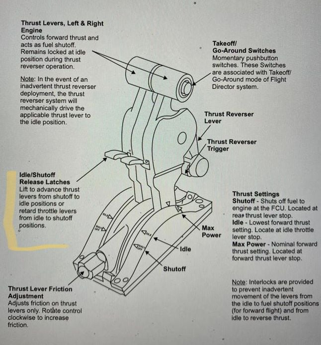

Here's a drawing from another site depicting the thrust lever quadrant:

The "speculative" argument is based on if the aircraft is flown from the right seat, when the PF calls for flaps, the PNF reaches across the control quadrant as the PF pulls back the levers while setting up the approach. With the idle stop release latches located on the aft side of the throttle levers, if the PNF arm across the quadrant its "possible" the stop release latch could contact the PNF arm and release allowing the PF to inadvertently pull the throttle levers below both idle stops effectively shutting down both engines. Since it appears in the report both levers were at or above the idle stops takes some wind out of the speculative side.
My SWAG is if that did happen I would think the first reaction of the PF would be "Oh F..." and he would have slammed the throttles full forward and left them there.
