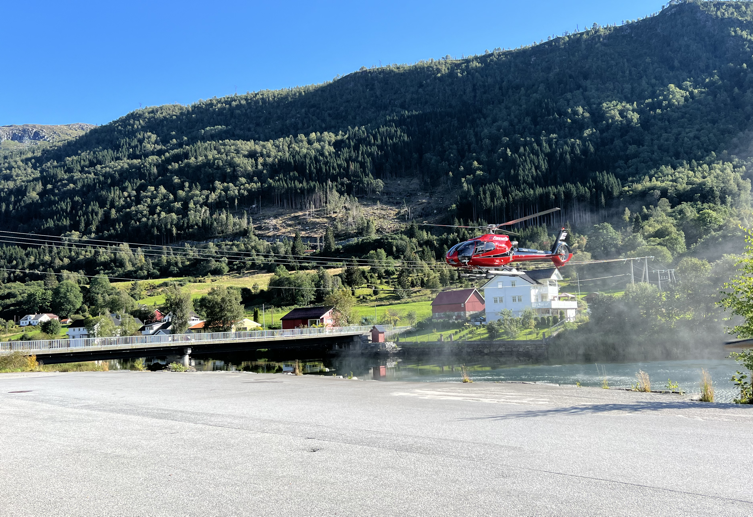

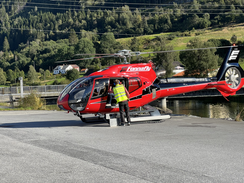

This sent to me by a friend in Norway. What do other helo pilots think of this clearance from the wires? As the second picture shows, the pilot chose to land like this rather than a bit further away.
