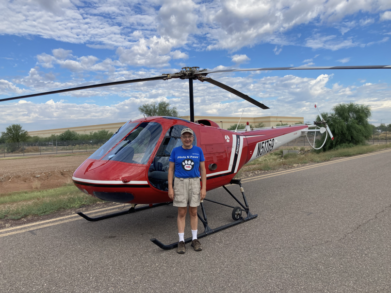

Some training in the Enstrom F28 Helicopter.
Today was my first lesson in the Enstrom F28. Flew a bit to the training area to practice some landings. This is harder for me than the Robinson R22 as you have to control both the throttle and collective manually. And avoid the dangers of main rotor stall! I enjoyed it.
