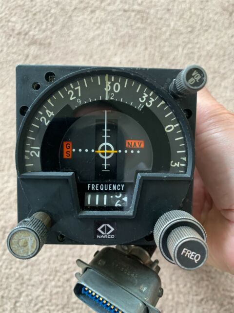

As to the radios: the radio was exactly as I suspected and perfectly fine for IFR. They did run into problems with the existing transponder so had to replace that. The VOR worked. The installed ADS-B worked. But The ILS CDI appeared to be deader than the proverbial doornail and is not being replaced anytime soon. So really can't practice precision approaches nor do an IFR practical exam in the plane.
Bottom line is the club is now up and running - finally!
It helps if the ILS receiver is turned on. Doh!
It is a Narco NAV 12 (combination Glideslope, Localizer, and VOR receivers) and as you can see in this picture the knob labeled VOL ID is also the power switch.
I assumed, incorrectly, the Narco NAV 12 powered up when the Narco MK-12D NAV/COM radio powered up. The NAV control on that radio is tied to a different VOR CDI display. However, the Narco NAV 12 is a self-contained unit - other than antenna connections it has its audio tied to the cabin speaker (for ident purposes.)
So the avionics effectively act as either two VOR receivers or one VOR receiver and a localizer/glideslope, and one COM transceiver. Wish it had a DME, but the glideslope makes precision approaches possible and the localizer and VOR make two types of nonprecision approaches possible. Sufficient to train and test for an IR.
